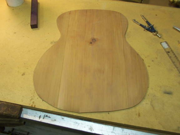

Has anyone had to relocate a soundhole? I have a redwood top with a knot in it that I can`t get around by shifting the outline. If I move the soundhole toward the bridge 3/8" would it be detrimental?

Got any pics of that redwood top Coe?

Here ya go, Serge. Not much to look at other than a knot precisely where I don`t want one. When I cleaned it up for a quick pic, dark lines showed up on each side around the glue lines. Maybe time for a burst, too.
PostPosted: Fri Apr 07, 2006 5:27 pm
Coe, just a thought, how about a bigger pick guard that would cover it, i'm sure i've seen it before, just forgot where i put it!
Seriously tho, if you did that, maybe you would not even need to change your soundhole placement and the scale BTSW?
This top is still lovely, whatever ya do bud, it'll look great! Serge Poirier38815.1040277778

Interesting project. What do you have there? A 5 piece top? How big of a sound hole are you planning? If you move it, remember it will show more of the rosette area between the sound hole and fingerboard. (unless you add to the fingerboard) I would lay it out carefully. Maybe going to a bigger sound hole (4" max is a good guide) and moving the hole slightly south might do it. If the knot is solid it might not be so bad to show a little of it. Plan it carefully. Just some idle thoughts on a Sunday morning.

One more thought. What scale are you planning? If it is a 24.9 and you change to a 25.5 you will gain about 1/10" in fingerboard lenght form the 14th to the 21st fret. That will move the soundhole the same distance.

Joe, Yeah, it`s a 5 piece top. I`m not really convinced that I`m gonna use it, though. Just enough of the knot is in the way that it`ll show a sure imperfection at the soundhole edge, and the dark lines on the sides stand out like a sore thumb. Thinking about the twelve fret idea with a burst around it to get rid of those lines (not enough left to saw `em out and rejoin).
The thing that really get me is the flexability accross the grain, and stiffness along it, and with the tap tone.

I'd work with that top and see where it takes you. And yes, a 12 fret guitar might be the answer.

If you need to move it 3/8, why not a 13 fret. I make at least one every year for a client. Its popular with guys who like the 12 fret idea, but dont want to sacrifice 2 frets. 13 fits the bill.

13 frets sounds like a great idea! its just a little compromise!! specially if you make a small body guitar! You can make a regular 12 fret guitar and call this an "upgrade"

Uh, Tony, did you look at the picture?
PostPosted: Wed Apr 12, 2006 9:16 am
hey, where DID I put my glasses ....
